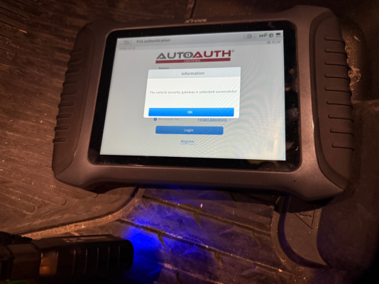

Yes, that is the one. Besides clearing codes it has a lot of "special function". When my son lost both keyfobs for his Mustang this thing deleted them from the system and programmed 2 new ones.
Here is the first page of the "special functions" menu. Not all will work with RAM. Even less will work with RAM >= year 2025.

dimulec
Mar 27, 2026
16
23
Dallas, TX
2025
Hurricane

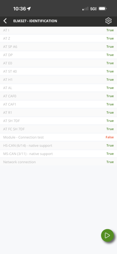

I have a different experience. Basically, it did not work for me at all. Here is the setup:
Big BT thing is for XTool and the small one is OBDLink MX+.
When I tried AlfaOBD and Jscan and they both did not want to connect to any modules. Without unlocking the security gateway this was the diagnostic screen:
Then I unlocked the gateway with XTool and this completely screwed up connection from the Jscan app to OBDLink.
Jscan was just spinning the spinner until I got tired.
But after reading the above post I think I messed something up. Maybe it would be better if I connect the XTool with a cable. I will try again.
