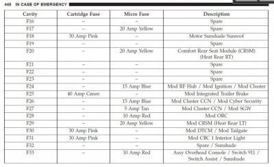

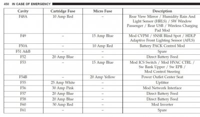

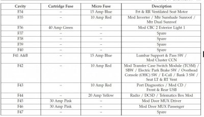

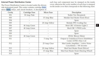

I do not know which are hot/cold, etc, but here is the fuse designations on the Interior Power Distro from MY 19 Bighorn with the 5.7L Non-Etorque... Best I can do:
