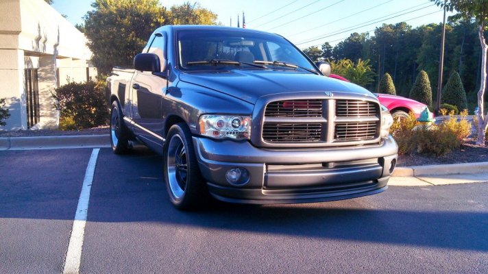

I have that done on my truck, 03. Gibson Super Truck Cat-Back.
The problem is the gas tank on the drivers side that prevents you from "simply" doing another set of pipes on that side, but with money it can be custom made.
