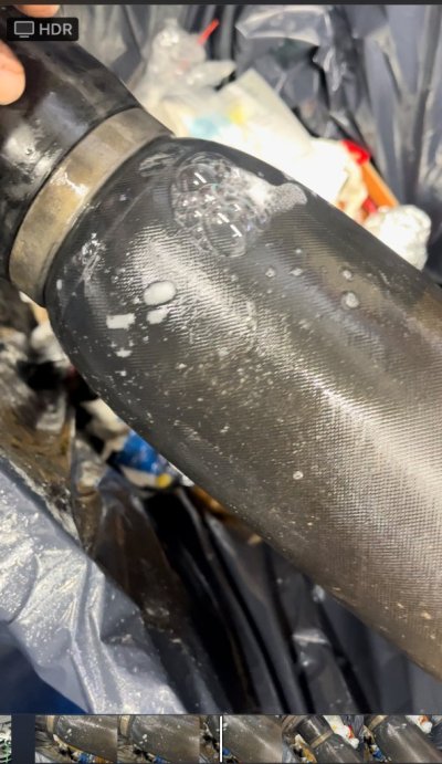

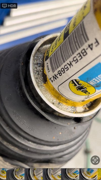

Well I’ve had three air spring leaks on my truck in the last 3 months. Changed out the right rear last night. Have the left rear waiting to go in at some point. Getting a bit costly….
Right rear was leaking at that top section of the air bag. Both fronts leaking out the bottom shock o-ring because of rust.
Trying to verify the leaks with the bags in the truck is a PITA. For the first air strut I removed it and submerged it in a bucket of water to find the leak.
