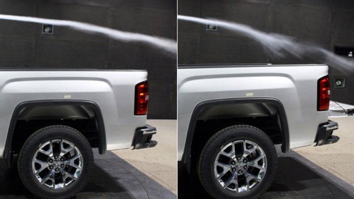

Tonneau's don't do a thing for fuel mileage, trucks are designed in a way that air coming off the top of the cab swirls towards the top of the tailgate, the cover is flapping because there's a large negative pressure area above it.
Trucks are designed for the best/least drag they can get from the factory (ford wanted to include a hard tonneau with a small spoiler when they started selling the ecoboost's because it gave them another mpg or two but something about the epa not allowing it during testing so they gave up), that's why running with the tailgate down or off actually hurts mpg.
A camper shell on the other hand would move the air from hitting the middle of the front of a trailer up towards the top of it, that imho would help a bit, at worst it'd help keep the bugs off lol
You can see the extra turbulence with the tailgate down, that equals drag

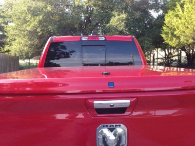

JOECO: I never really concerned myself with MPG, with/without cover etc, as I figure if U go and buy a Hemi, MPG should not be the 1st concern, lmao, all IMHO........
The HARD factory tonneau cover (fiberglass) painted to vehicle colors "installed" is appx $1733.00, ask me how I know, LOL>
AGAIN, depends upon yer needs and truck usage
