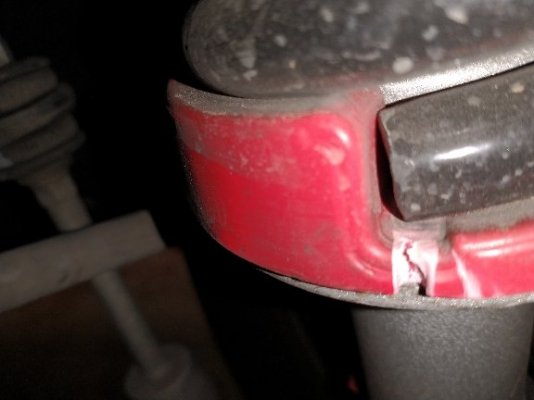

Its official, Rancho is a piece of crap.
I was doing tranny drain and fill and notice the other strut is broken.
Dammit!
I would do a spacer and upper control arms but i threw the old ones.
Does anyone know if the rough country preloaded struts will require upper control arm upgrade on a 2014?
what is your budget because the rough country is most likely going leave you with more disappointment. I would highly recommend moving to the fox 2.0 coil over or icon. The Bilstein 6112’s don’t need the oem coil seat. You get what you pay for hit up @Nick@GotExhaust for the best prices

I hear ya on you get what you pay for, come on isolators aren't supposed to break. I just want a lift. Not much else.
I dont offroad or do anything rough.
I have to be cautious what i buy because i read so many threads mentioning that longer shocks and/or spacers can over extend and pull the upper ball joint out

I agree even the quick struts at the auto parts stores are running those isollators. I'm not recommending better means off roading im recommending for the better ride price wise you're not far off and if you are unhappy or disappointed again it will cost even more
