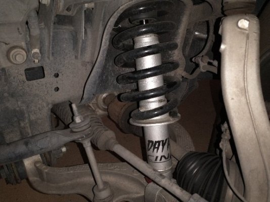

I went with rancho to avoid upper ball joint issues.

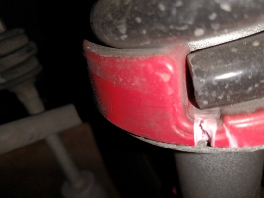

After 10 months the lower isolator broke. Its glass filled nylon not urethane.
The lifetime warranty is a bunch of crap. Rancho does not do warranty claims. You have to go thru the dealer. So buy somewhere reputable. I bought from amazon LLC. They couldn't get a new one till november or december. Had to get a refund and buy locally, losing $80 in the process.
I dont offroad or go on rough roads. None the less isn't rancho supposed to be for offroading?
Rancho couldnt provide with a replacement part nor apologies for putting my life in danger

No they're not offroad shocks and you're the 2nd documented case with that lower isolator self destructing on its own that've seen around here. Not good for Rancho's reputation. as for your life being in danger, lol. it's an isolator, not the bolt holding your entire strut assembly down.

I hear ya, i wasnt in eminent danger. The isolator is there to evenly load the spring onto the perch and provide abrasion resistance. The spring is now applying the weight onto a smaller area. The metal used isnt the most thick. Luckily i only had to drive 25 miles home on a smooth road.

The metal used is steel and its 1/8" thick. Same thickness as most aftermarket steel bumpers.

I know it sucks and again i would't blame the guy for wanting to throw them in the garbage. I won't sugar coat it those isolators are probably crap. I believe a bad batch may be at play. I don't get paid by Rancho just in case i just think chit happens. You see if this was Fox or Bistein people will say it was somebody smoking pot who did the assembly, but when it happens to Rancho or RC the collective minds all come together to complaint about how chitty these products are. Perception is everything. Nobody in this forum seems to have an issue with 5100's washer design and if it's not installed correctly either the strut and/or the top mount can get messed up. Eibach doesn't have that issue because Eibach makes it right.
Write an email to Tenneco and link your thread and the other i posted where they can see pictures. I'm sure you and the other dude who had the same issue won't be the only ones having the same problem . Help the community letting them know there is something ****** up wrong about their isolators or anything they sell.
Check the other strut too and make sure the other isolator is not about to crack. You can always buy 5100's or RC or Eiibach etc or work something out with Amazon and try get the 2nd Rancho strut new. i know i'd like to have both of them new to make sure i don't have to go through the process again, or i'll throw them in the trash and start over with something new.

The bottom of the coil is straight cut so it is necessary to either have a die stamped steel lower mount (which nobody sells as a unit a la carte) or a molded ramp to distribute the weight on the bottom coil so it doesn't bow or experience secondary harmonics from unequal loading (which is noisy and reduces the longevity of the coil).
It would be possible to mill out a ramp too but nobody could economically justify the machine time to manufacture like that for a product any of us care to afford

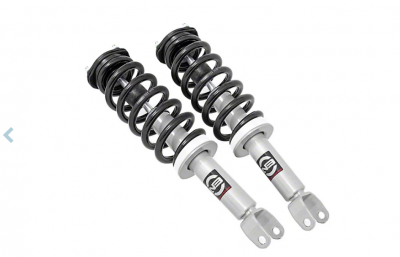

I have the Rough County N3 preloaded struts and have not had any issues. They are the best value right now in the market. I got exactly the height lift they claimed. It's a option if decide to take off the Ranchos. Good luck.

I just looked at the rough country and remember why i didnt buy them.
It comes with spacers. 2 things, spacers cause upper ball joint issues in my truck also i didnt need new shocks i could have just got spacers.

Spacers? Mine didn't come with any spacers. Just the strut with spring already mounted. I didn't need anything else. The UCA angle looked great after the installation.
Basically you are taking one strut or and replaced with another of the same but slightly longer.
https://www.roughcountry.com/dodge-leveling-struts-500028.html?find=2018-dodge-ram-1500-4wd-739638

Its official, Rancho is a piece of crap.
I was doing tranny drain and fill and notice the other strut is broken.
