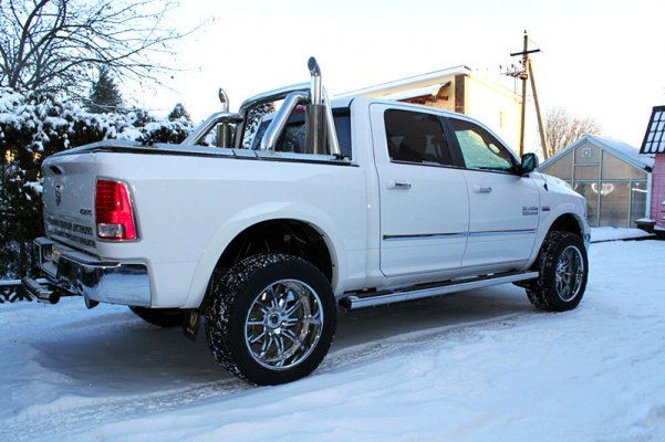

So, i've installed HF tune "91-Octane-hf" and the first run was 5.80 seconds 0-60! that's not bad!!!! I have to send Sean some logs, may be it would be even better :)
so the results
stock: 7.6 sec
diablo tune: 6.5 sec
hemifever: 5.8 sec
I have to mention that my truck does not look like a drag car )

definitly not what you see at a drag strip... but a nice truck you have
