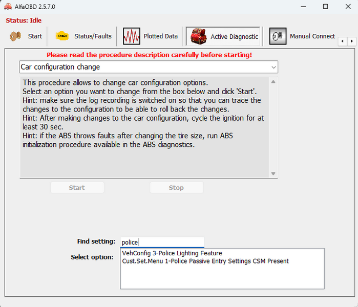

Another issue for me….. I have twice walked out of the kitchen at night….to discover I’ve left the dome-light “on” for hours.
I think I need to get this thing onto the ordinary dome-light circuit.
Anyone familiar with which wire color-code i should be looking-for in 2015?
The 2013-2016 Service manuals are at this link.
Download the PDF to a PC and use Control F to word search for the circuit schematics.
Or, get AlfaOBD and remove the police lighting feature option shown in post #3.
