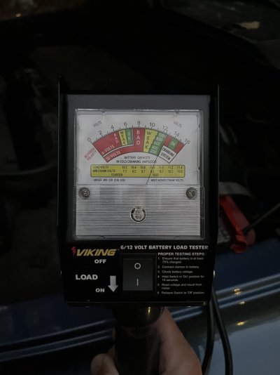

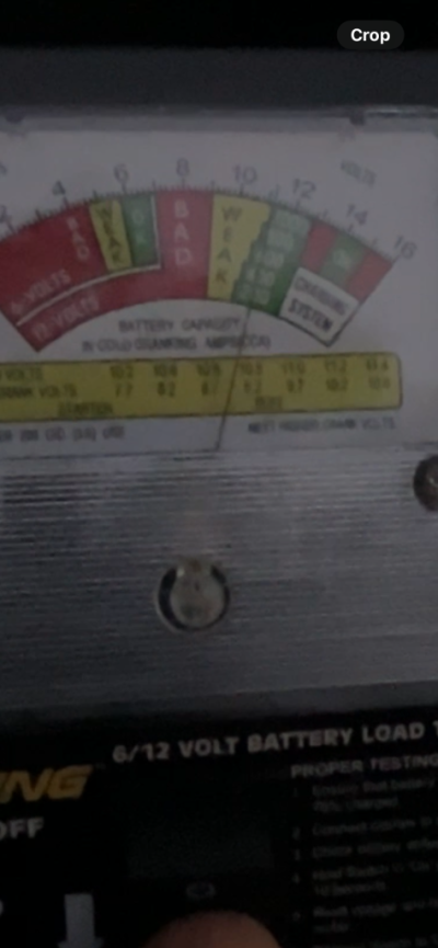

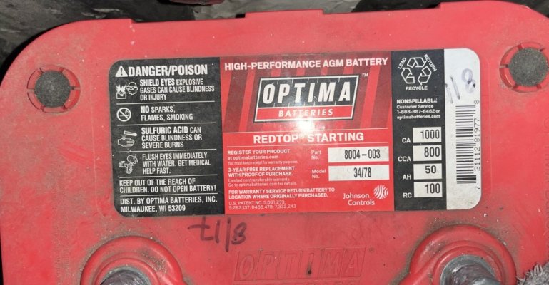

Ok, done. Truck has been sittting for 9 hours without running. Disconnected the battery and ran the test.
800 cold crank amps according to battery:
12.4volts
Then I ran the load test and it never dropped out of the green for even 1000 cold crank amps. Screen shot from video during load test:

You're most welcome and thanks for the detailed report.

Thank you Hanover. I will keep that in mind. The battery itself is 8 years old but still healthy. Baring any problems before the battery needs to be replaced, I'll look at the lines when I get a new battery. It's the original starter too so I'd imagine it's gonna go at some point. Thanks again gents.
