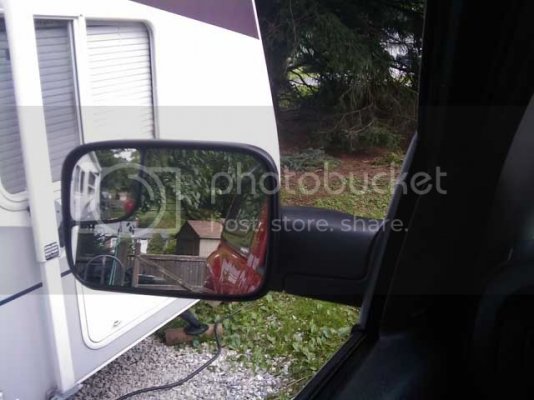

Kool vue mirrors

Wermbang, those look gooood
