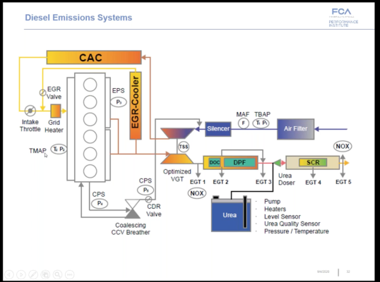

The DEF system is upstream from the DPF filter. That system reduces the NOx.
The SCR which uses DEF is after (downstream) of the DPF. It's located after to reduce soot fouling.
The DOC that is usually upstream or combined with the DPF.
