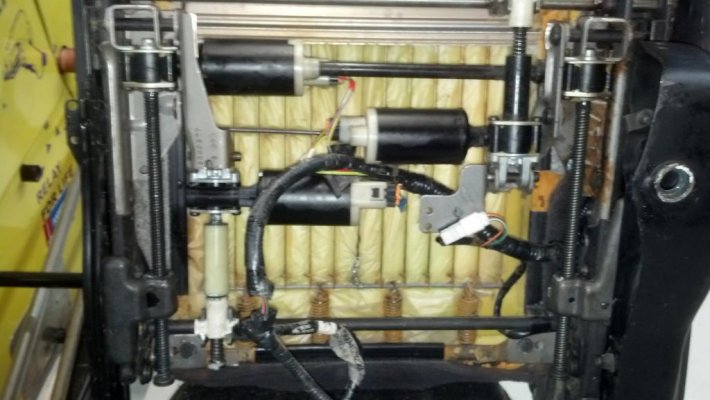

Nice catch HemiLonestar
I just saw the 2009 & the Cummins did not register
Heavy duty Ram trucks are always 1 year behind the 1500 models
So her 2009 Ram with Cummings would have 2008 Ram parts for the most part
Your seat bottom will be very similar to this image
