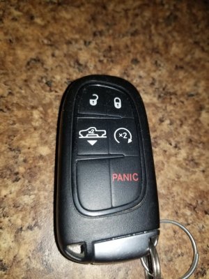

I accidentally found out that if you lower the suspension via the FOB, the truck will stay at entry/ exit mode at all times, any speed
That should not be the case. Mine raises back up automatically no matter how it gets in entry/exit.

There's a button on the fob you press twice to lower the truck before you get in it. It's the middle left. Using it to lower the truck has the same effect as using the dash button.15639038768068500111206110944499.jpg

Yes i know that but the truck doesn't stay low when you drive away
