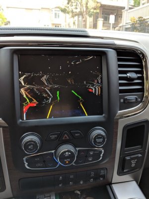

So, mysteriously, I got my cruise control to engage again, exactly a week to the day I got it back from the dealership! I was pretty pumped on my way into work just now, but when I backed into my parking space, the image from the rear-view camera was seriously distorted! It had been fine ever since I bought it...until today! Now I understand the two may not be related, but how to explain that everything worked perfectly on this truck until I took it in for recall work! I guess I'll keep my appointment today and have the shop look at two things now...or can they remove the update? I should've left well enough alone.

I haven't done the recall/update yet but I was having that issue with my backup camera. After taking it in a couple times (once they said it was a connector at the tailgate...) and it not getting fixed, I finally spoke with the service manager and he had the camera replaced. 2,000 miles later and I haven't had another issue with it.IMG_20180429_124812.jpg

I haven't done the recall/update yet but I was having that issue with my backup camera. After taking it in a couple times (once they said it was a connector at the tailgate...) and it not getting fixed, I finally spoke with the service manager and he had the camera replaced. 2,000 miles later and I haven't had another issue with it.View attachment 135193
That's EXACTLY the picture I was getting after the recall work was done, snoty...thanks for the post! Mine has been so intermittent, though, I'm not sure mentioning it will do any good because with my luck, the tech won't be able to duplicate it. Naturally, it's been working fine for the last week.
Nonetheless, I'll tell the SA when the Reb goes back in for the cruise issue...fingers crossed both items will be fixed!
TXCOMT
Mine was intermittent as well, but sometimes would be stuck that way for a few days. I took a picture on my cell phone every time it would happen and I would bother them about it every time my truck was in for an oil change. Finally when a SA told me that it "was the nature of backup cameras" I blew up and went to the manager, who got the camera replaced.
I think ya’ll are barking up the wrong tree.
The experience is you see on the camera is a result of a loose connection and/or wiring harness. The camera is typically replaced as a standard practice.
When it happens a loving bump with your hand typically will correct it in the short term.
Software wouldn’t cause the camera to work intermittently or respond to a physical bump.
