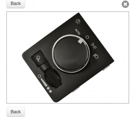

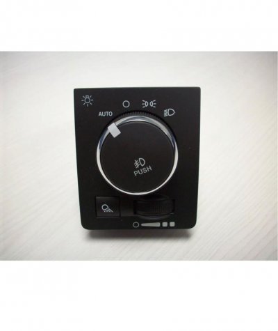

No. You have to add the wiring yourself. If there is no symbol in the center of the headlight switch knob then you are seeing the button for the cargo lights
You'll need the correct switch, the fog light harness that @M2Mods makes ( not something Mopar offers separate), fog light jumper harness and the correct sales code added
Non fog light equipped
Fog light equipped
