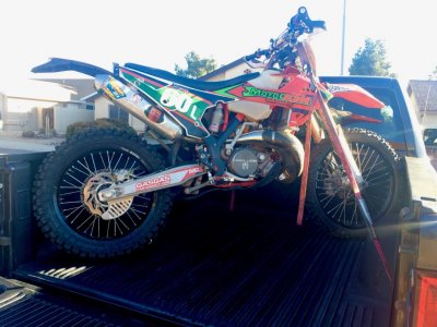

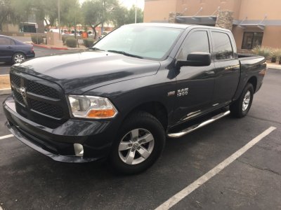

I found a 2014 RAM 1500 2-wheel drive (my first non 4x4 since 1985) Express crew cab with only 54,000 miles and no dings. The crew cab shortens the bed to only 5.5 feet, so I have to angle the dirt bike in if I want to close the gate. Probably going to get a camper shell and do a hitch mount carrier for the bike at some point.
I did a CarFax. Put a wooden dowl rod to my ear and decided the tick-tick-tick is an exhaust leak rather than a lifter/cam horror story. (valve train sounded quiet).
