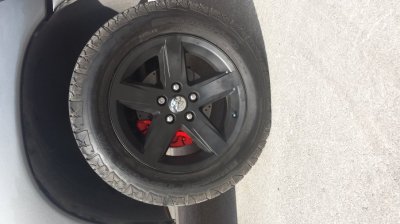

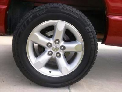

Used Plasti-Dip on my rims. Totally changed the attitude of my RAM. Definitely a cheaper alternative to powder coating....if you don't mind the occasional touch up. Or if you just wanna see what your truck will look like with Blacked Out accessories before you spend money on a more permanent solution. Also while I had my wheels off, went ahead and painted my brake calipers.

Nice man. Im about to dip my wheels as well. Looks pretty sick on yours. Did you just use spray paint on your calipers? Your truck would look sweet debadged too. :naughty:

Yea regular old Rustolem spraypaint. Probly should have used a heat resistant paint,but...... I have a tenency to do things before I think em through all the way. Lol! Considered debadging or at least Dipping em, but I still love my chrome bumpers and the badges tie in to them well. Didn't wanna over do it. I ve seen some guys that once they started Dippin , they took it too far.

Thanks for the comments guys! FYI, make sure you put it on thick like the website says! When you get ready to peel it off, its so much easier. I found out the hard way. Put it on too thin and ended up having to order the DE-Dipper to eat it off! Good lookin RAMs yall have! DerekP ,personally I think a liitle flash of red in the wheel wells would look badass on your black RAM. Yellow is another option that would work well. Im gonna keep experimenting,after all you can just peel it off!

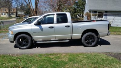

Dipped myn as well. Used the glossifier too. One side i used rustoleum flexidip MISTAKE that sprays more direct and a pain to even coat large areas. PLASTIDIP all the way.
dipped my step bars too. Dipped my grille inserts and next will be the decals somehow...
Painting my calipers silver to match the truck with duplicolors caliper paint kit this weekend as well.

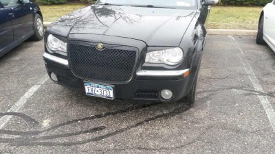

Also did my buddys grill on his 300 but as you can see it peeled a bit only after a few days due to bad prepImageUploadedByTapatalk1431719142.905983.jpgImageUploadedByTapatalk1431719151.772298.jpg
