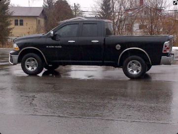

Nice looking truck!
I'm also looking at leveling kits. I live near Vancouver in Canada and was quoted around $500 for a 2" level and alignment.. Plus 12% tax... RIDICULOUS :shakehead: not happening. Call the Les Schwab just accross the border - $314 all in :)

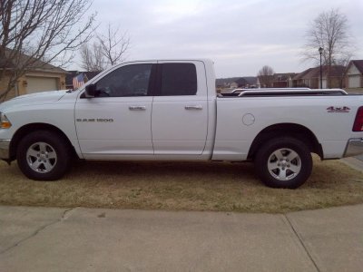

i paid $79 for 2" HBS level, $100 to have it put on, $70 for an alignment.............in Arkansas.
