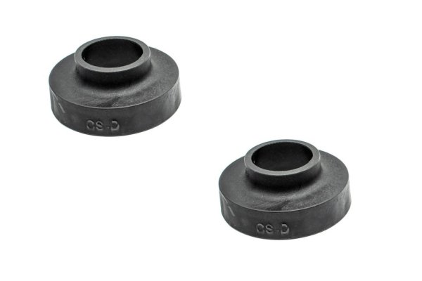

#1 Yes you can, but you will have to re-engineer your air line hookups, they come out at right angles and do not have enough length to get more than 1.5in spacer above the strut.
#2 Unfortunately not above the spring because the rear airsprings clip into the upper spring pocket for retention when deflated or when vehicle weight is removed from the wheels and the suspension sags. (think a 2 post lift or jack stands under the frame not axle)
You may be able to use one of the machined lower perch extensions under the bottom as that end is kinda a press fit onto the axle nub, not much retention on that end.
#3 I can't speak too as I only went up 2in and haven't experienced anything regarding the angle.
