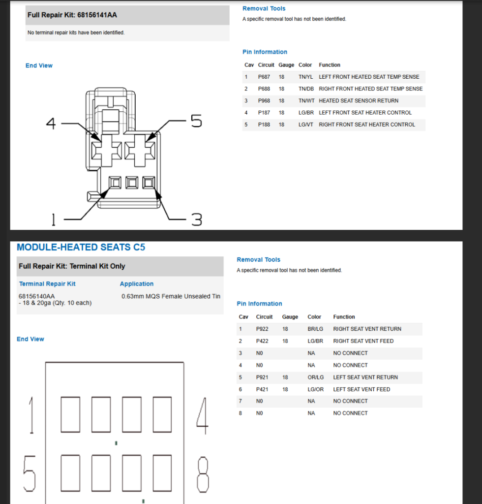

Hey all,
I’m in the middle of a heated/cooled seat retrofit and hoping someone with experience in the factory systems or previous retrofit work can help fill in a few gaps.
Truck: Ram (originally equipped with heated seats & heated steering wheel)
Seats: Full Katzkin leather set w/ heated & cooled modules
The factory heated seat modules and wiring were retained, but I sold the old seats. My goal is to fully integrate the Katzkin modules with the OEM controls so everything works seamlessly—heated/cooled functions, level indicators, etc.—without having to hack in aftermarket switches.
Current Plan:
  • Use relays or possibly a Raspberry Pi to intercept/translate factory outputs to the Katzkin modules.
  • Simulate OEM loads (dummy resistors) so the BCM doesn’t throw errors or disable functions.
What I need from anyone with access to factory heated/cooled seats or understand there of:
✅ Resistance readings for:
 • Heating pads (upper & lower)
 • Thermistors (likely NTC – Negative Temp Coefficient)
 • Ventilation fans
✅ Voltage/PWM data for the factory seat heat/cool control outputs. Does the factory module deliver PWM or simple variable voltage (0–12VDC) for pad and fan control?
✅ Any known strategies for fooling the system into thinking OEM components are still present—e.g., dummy load values, bypass methods.
Findings so far:
  • Thermistors appear to be NTC. Charts for similar setups suggest a 10kΩ resistor simulates ~room temp.
  • Upper pad resistance: ~3–4Ω | Lower pad: ~2–3Ω
  • Fans: <2Ω, likely controlled via variable voltage rather than PWM. No dedicated temp signal for fans—they seem to engage as long as a load is present.
I’ve already enabled heated/cooled seat support in AlfaOBD, and the modules power up. Now I just need real-world resistance/voltage data from factory seats to finalize the integration.
Any data points, wiring diagrams, or firsthand retrofit experience would be greatly appreciated.

Ok so first round of testing dun I was able to trick the computer with a 7.5 ohm 100w resister and a variable resistor for the temp sensor I also validated that the aftermarket temp sensore also worked and found that the the temp sensor is a safety not controll varieng the resistance does not change the voltage output till it gets to low or high then it just errors and shuts off so on high it put a steady 2.1 volts and and on low 1.1 volts still need to figure out the cooling but this is half the battle I've also verified the aftermarket seats are controlled by a momentary switch 1 click on 1 click medium 1 click low 1 click off with corresponding lights so next will be to use a pie or Pico etc to take 2.1 volts on heat mean close/open relay 1 tim verify power on signal wire for high then 1.1 volts open/close relay 2 times for low verify signal wire for low has voltage then no signal cycle relay again till no signal from seats is present or something for similar so I'm stoked that this will work :)
