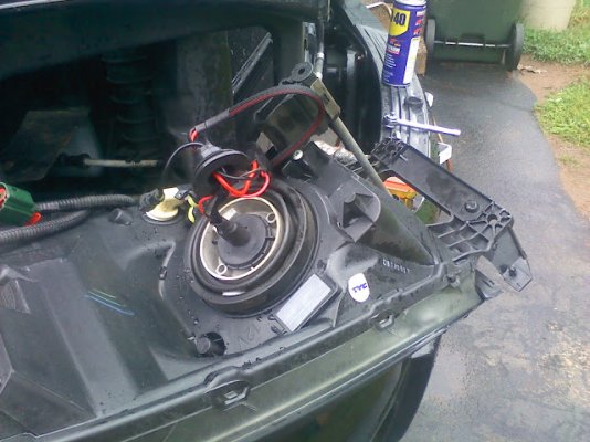

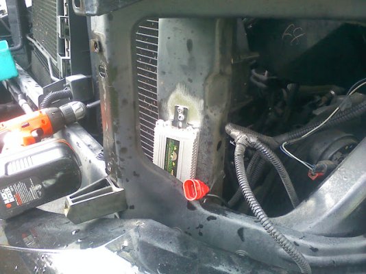

The kit is fairly straight forward.Mounting with self tapping screws made that part a breeze. Disassemble both lamps. one nut in the fender well, and 2 screws on the inner skirt. 03-08 I think. The headlamp will pop out with a pry tool or a well gripped tug . BECAREFUL with the pry tool.

Well with some crafty test light maneuvering, matt9(lb37) We had too omit the resistors, turns out they fried the original ballasts. (they were hooked up right) But they clearly were the culprit. We took them off, And used the ballasts from the fog lamps. I'm really happy with the results. See for your selves!!
