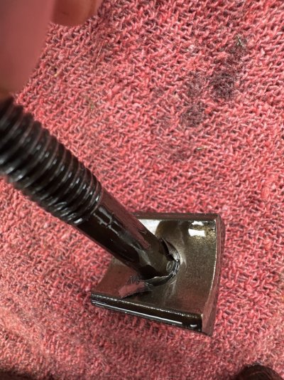

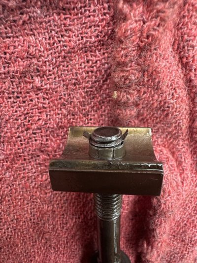

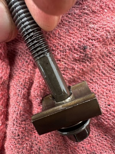

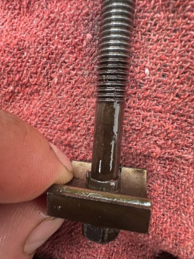

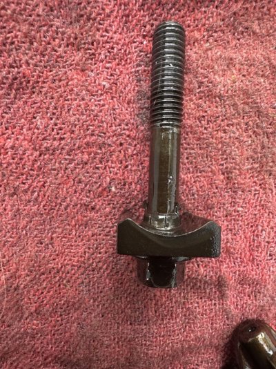

So pulled the rocker arm shaft today and inspected those retainer clips that are referenced in the star case and these are my findings. I don’t really know how it is going to post but the first image is front with the last image being the rear bolt.image.jpg

I may be wrong but the oiling comes up through the threads through the rocker arm shaft to oil the valve springs and lifters. If passage is blocked then this could be causing the poor lubrication of everything and in turn the noise I am hearing.
