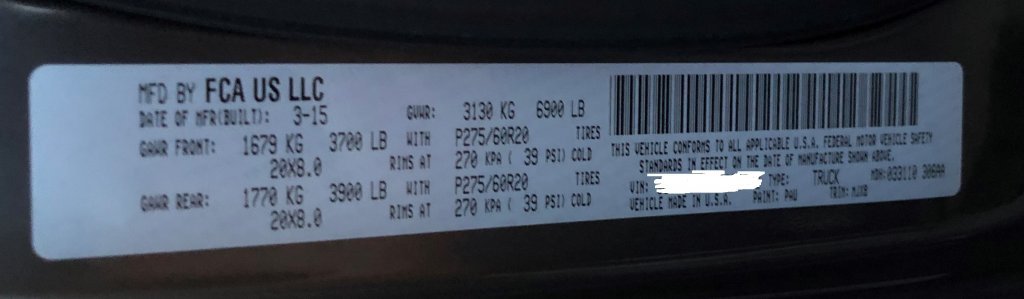

should look like this.

Thanks I'll check when we get the truck back, but it did not look like that as I recall.
