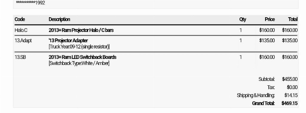

Just ordered the following from Jeremy at RetroShop.us
- Diode Dynamics Switchback Halos & C-Bar Led's
- Diode Dynamics Switchback LED Turn Signal Boards
- 09-12 Projector Lights Adapter Harness
I also bought everything else i will need from Pep Boys, including sandpaper, paint, primer, paint stripper, prying forks (to open lights), black silicone for extra sealant after they get sealed with Morimoto Retrorubber, clear epoxy to help mount halos and those twist ties with metal inside them, T10 torx driver to disassemble the lights, and some dremel bits I'll need.
So far ive got $540 in parts and tools. The lights cost me $250 (I know I basically stole them. They are mint and look brand new). So im at $790 right now for everything and there is still a couple small things I'll need. You may be able to keep the amount lower if you have some of the tools and items needed.

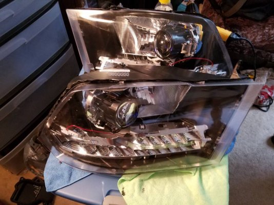

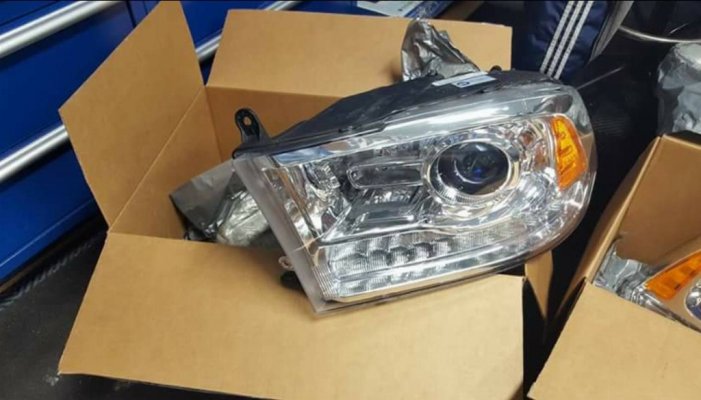

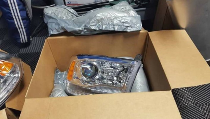

Ram into a huge snag.
Headlights won't fit into the oven lol.... It's a small oven.
Had to break out the heat gun. What a bad idea. The outer lip of the housing took one hell of a beating and is pretty bent up.
I finally got both open. First one took 2+ hours. Second one took 1 hour.
Today, I'm going to use the heat gun to reform the lip of the housing and the locking tabs.
USPS says the halos and boards will be here friday, so I've got a few days to prep, paint and get the housings back to normal.

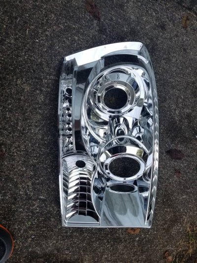

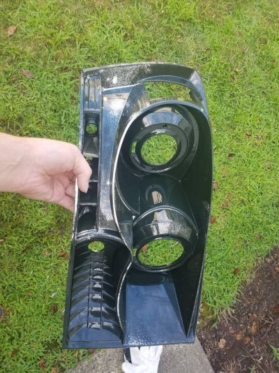

Oh, i had a single headlight from my old 2006 Ram in my shed. Tried to sell on eBay for 6 months and no luck so I decided to use it as a test light.
Here are some pics of the old 2006 Spyder light.d5f1d7d575a6c4090a5b99967c7de7d1.jpg
And here it is after I soaked it in Easy Off Oven Cleaner. Took 60 seconds and all the chrome disappeared. Perfect.
Im using this light to test certain things before I use them in my good lights.

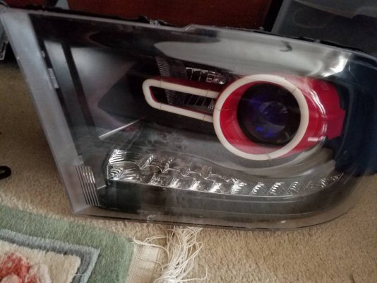

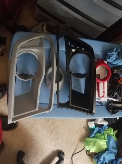

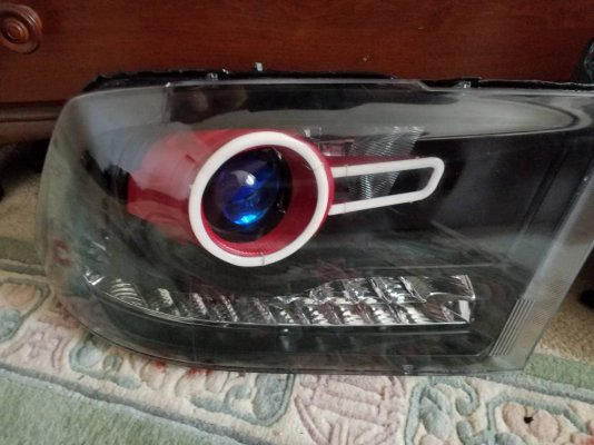

Update.
My Morimoto Retrorubber came yesterday.

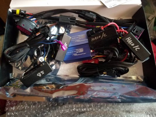

My box of goodies came from Retroshop today.

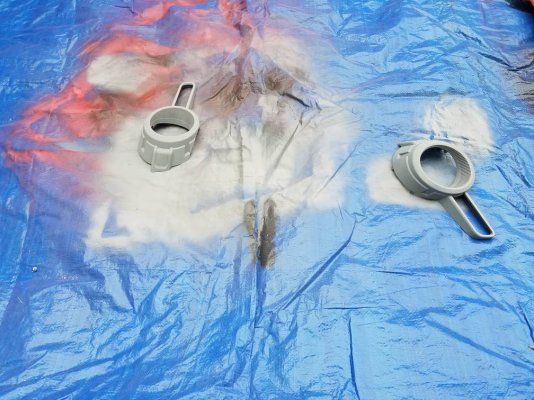

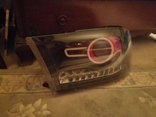

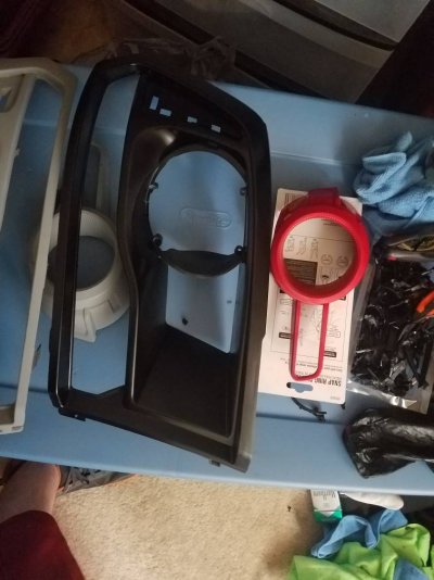

I stripped, wet sanded, primered and painted the housing and projector shrouds. Came out really nice.
I got the Switchback LED Boards mounted and wired in. I also wired in the Switchback Halos and C-bars. I temporarily mounted them with beading wire so I can hook it all up on my truck and test everything before I permanently mount them with epoxy and then discover a problem.
Here is a picture of how the first light looks all test mounted. The bottom DRL running light lense is off as im waiting for the Klearz Smoked Lense to be delivered. The Side Reflector is off aswell, as im waiting for the Klearz Smoked side markers to be delivered aswell.
Overall im super happy with them as they sit right now. So excited to install them when their done and finally have proper Hids.
More updates as they happen. Full install write up will be posted once they are complete and working properly.

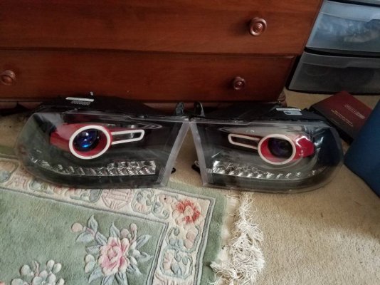

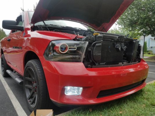

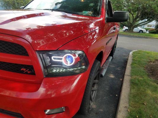

Just tested everything out and the lights are properly wired up and everything works.
Write Up and how to guide and video should be done and uploaded here by next weekend.
ae926f7ab5ebe12c75c4f1f768ff8cee.jpgb8dac3a70b317ce1c82076e85eff76b6.jpgdfee2f72730ab6038466717a26ab52c4.jpg

The white parts are Diode Dynamics Switchback Halos and C-Bars, not paint. Here is a list of what will be done when their finished.
• Diode Dynamics Switchback LED DRL Turn Signal Boards
• Diode Dynamics Switchback LED Projector/C-Bar Halos
• Klearz Smoked Clear Corners
• Klearz Smoked DRL Lenses
• Retroshop 09-12 13+ Projector Adapter Harness
• Retroshop Morimoto XB35 6500k HID Kit
• Morimoto Retrorubber Re-Sealant
• Custom Painted PR4 Flame Red & Gloss Black
