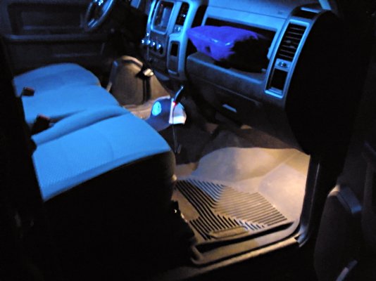

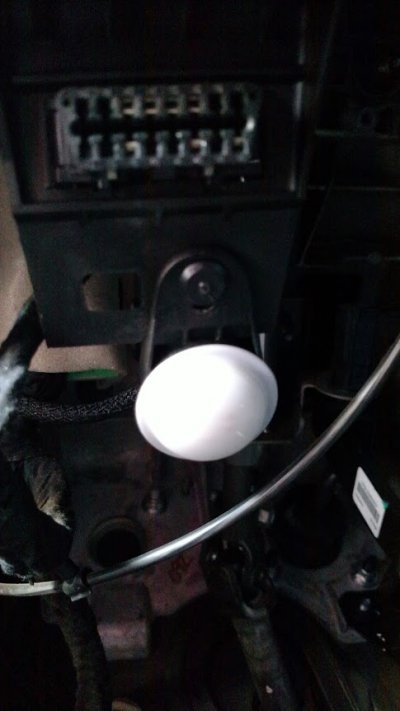

Installation was easy. Thanks for the instructions. The kit with the small snap in bezels (see above) make it a breeze.
Drivers side, I just untapped the harness for slack and slipped it into the hole behind the OBD2 port. Pushed the bezel in from the other side till it locked in and done. Holds in place great.
Passenger side. Cut out small rectangle in carpet cover. Enlarged slightly to accommodate bezel and snapped in. Bezel holds in place.
Well worth the $45 and an easy installation.
