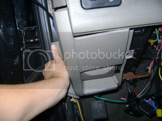

Start by removing the basic plastic trim pieces:
Drivers and passengers kick panels- just pry up, be careful and get as close to the tabs and pull so you dont break it.
Plastic piece under steering column- just two screws and comes down
Plastic piece under cup holder- Two tabs holding it on, just pops right off
Top dash piece, part closest to the windshield. I believe you just pry up by the tabs and it comes right off. I had a dash cover and the piece came off when I removed the cover.

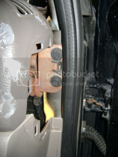

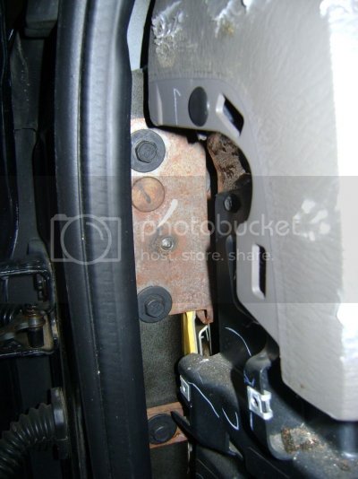

Passengers and drivers A pillars. Two 10mm bolts hold them on, flip open the covers by the handles and you wil see them. Then just pull
Next the two platic pieces on the sides of the dash, also pop right off.(Disregard the silicone all over the dash, it held the cover on. Also the wires everywhere, I took the pics a little out of order... yours shouldnt look like this yet)

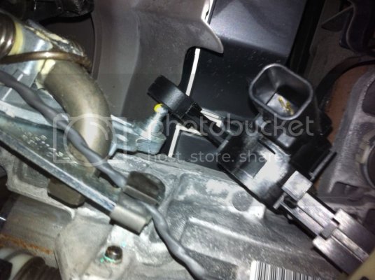

Now that thats all removed, and its been about 15-20 minutes since the battery has been disconnected, you can go ahead and start taking the steering column out.
First remove the little rubber piece that controls the tilt for the wheel. All you have to do is pull hard toward the seat.
Look under the column and there are three T20 torx bits(the two visible ones and one next to the tilt control) that hold it together. Pull those then pull the cover apart.
Now unplug all the wires that connect to it. I believe there are three electrical connectors, plus the shift cable(Check over yours just to be positive before removing it). For the shift cable, simply disconnect it at the top on the little ***, then push the two black tabs together above where it sits in the metal and pull it through. Theres also a little white connector for the brakes, just push and turn and it comes right out.
Next remove the coupler, just one 13mm bolt. It needs to be removed at least past the male end of the column shaft because theres an indent in it that holds it in.(Mines not completely removed yet in the pic.)
Now all there is are four 13mm bolts holding it up. Remove all of those and you will be able to pull the column out.(Heres two of them, the other two are identical and more towards the top of the column.)

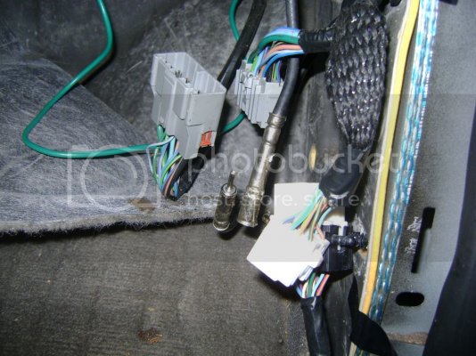

Now on to the rest of the electrical connectors.
On the passengers side youve got three where the kick panel covered: the radio antenna, the HVAC box controls, and I guess door stuff... idk. But these all need to be disconnected.
On the drivers side youve got all youre wires that go into the firewall. Remove the 10mm in the middle of the box, the connector on the left of the box, and the one on the right if theres anything there.
Youve also got a connector in the drivers side a pillar that needs to be remove. Also check the passengers side for one, mine didnt have one but check anyways.
Theres also a connector underneath the cup holders and to the left, its yellow. I believe thats it for the electrical connectors, but check, check, and re check everything, youre truck might be different than mine. You dont want to rip any wires when pulling the dash. Basically if you see a connector, pull it, it cant hurt.

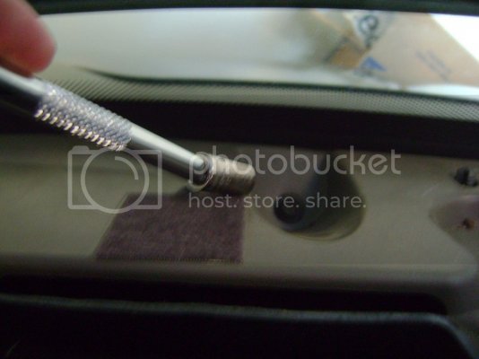

Four 10mm bolts on the top by the windshield, and 4 screws/8mm bolts i believe
