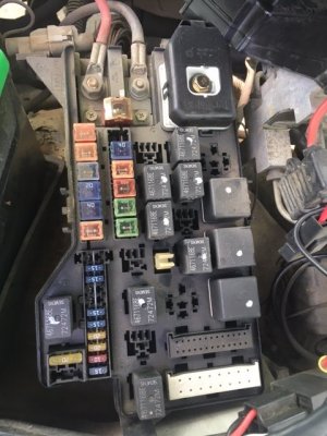

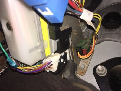

These are the pictures I just took. The first one is the little bundle of cables etc. under the dash that I was referring to. I remember being able to take that thing off before, but it didn't come off today. I think I remember seeing some video somewhere, that said that the white connector with a black latch, has the right wire to splice to put a killswitch in place, but I couldn't identify which one that is, because a few of them turn from cold to hot as the ignition switch goes on.
Anyways, the pics of the relay box are here too. I realized, that the small relays are all the same (7 of them), and the larger ones are also the same (3 of them). Assuming that the prospective thief is a bit smarter with electrical circuits than I am, I guess I will need to pull out all 3 larger relays to make sure they don't just move one over? or would pulling any single one disable the truck?

I suspect you could just pull the starter relay and call it good. If they get into the truck, and try to jumpstart it, and it doesn't start, they will likely just move on. Not likely to take the time to pull out a flashlight, find the fuse box, and figure out which relay to move.
If the crooks were that smart, they would probably have a job in the first place...
