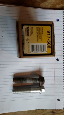

1539531150509-1065311150.jpg I'm not sure if this has been posted in here yet but I went through a hell of a time trying to find the hub to knuckle bolts for my 06 Ram 1500 5.7 Hemi 4wd and to no avail. However after a couple hours of research up and down multiple websites I found Dorman part number 917-508. The number comes up as a hub bolt kit for older Chevy's I believe but my local parts guy had a couple boxes on the shelf that I was able to compare to the factory hub bolts. I picked up 2 boxes for $32 and change. Each box comes with 4 bolts that are M14 x 1.50. I hope this saves someone else a headache in the future.
