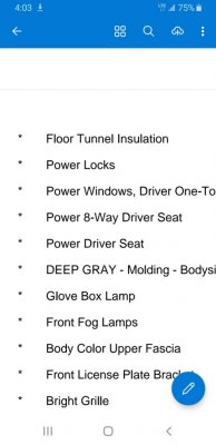

https://fcacommunity.force.com/RAM/s/equipment-listingSomewhere on this site is a link to a build sheet web site. I found out mine came with remote keyless entry. I only have aftermarket remote start fob. I now know I should be able to buy replacement remotes and program them. I assumed mine came with them being that it is a hemi sport and not a base model.
If you can find the link, it should tell you if yours has the module.
