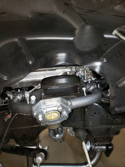

I am installing an IHC (Inez Hot Rods / Suspension) 4/6 lowing kit on my dads new 2021 5th Gen 1500 2WD. Having problems with the strut lining up with the lower control arm. Seams to be too far inboard and to the rear. The strut hits the frame and can't go inboard far enough to line up the holes. It also hits the sway bar and the lower mount seams to be way further rear than the stock arm. Anyone know what I am doing wrong?
This is the passenger side
Also do I have the upper control arm ball joint correct?

Where you able to get this done? I did the 4/6 IHC on my 19' and had to modify the bolt, you also have to cut down the (**** can't remember the name) steering link. And you have to trim other stuff.
