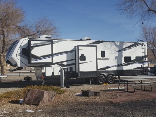

I already have a 5th wheel. My truck divides it's time between towing a 37' dual axle, triple slide, Momentum 350G Toy Hauler, and hauling the Artic Fox 992. The Toy Hauler works great for trips where you are going to be going someplace and staying for a week. It is far more comfortable than a pickup camper and doesn't cause the top-heavy feel of the pickup camper. But it is way too big and hard to maneuver to travel around the country easily, while staying someplace different each night.
I will retire in 363 days (but who's counting?), and when I retire my wife and I want to spend months at a time traveling through the US, Canada, and Alaska. From experience, a pickup camper works great for this. You can go pretty much anywhere you can fit a pickup truck, including some rougher roads. And you can park in normal size parking lot spaces. But you really have to plan your route ahead of time with the fifth wheel, because it won't fit most places.
We plan on doing lots of traveling when I retire. I'm sure we will use both RVs
Speaking as one whose in-laws tried it out, living out of a camper can be difficult, especially in a smaller one. When they retired they tried to take a smaller fifth wheel on the road with their three pomeranians and they felt cramped, and also that they couldn't take everything they wanted to live comfortably. So they traded that setup in for his last F450 and a toyhauler, a big Spartan (I don't recall the model number but it was 43' long). They enjoyed themselves then, having the extra room everywhere.
You're absolutely right, you've got to plan ahead with the fifth wheel, most 'off grid' campgrounds aren't going to have room for you if that's your thing. But what they did was plan to go to an area, stay a week or two, and take day trips everywhere they wanted to go. It also allowed them to have their own washer/dryer instead of having to pay for a laundromat. So there's definitely advantages to going the fifth wheel route instead of the truck camper, but try it out - you might find you like the truck camper better.
