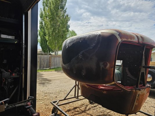

It's as hot as 2 rats fucxing in a wool sock this afternoon. This is as far as I got. Only warped in one spot so I relief cut it and will stich it tomorrow. I wish I had a spot welder to pull the welds out were I don't have access from inside the cab for my hammer and dolley. . So my slide hammer and self tapping screws had to do.
I don't like using more than 1/16 to 1/8 of Metal-2-Metal , so I got a fair bit of dolley and hammer tommorow as well.
