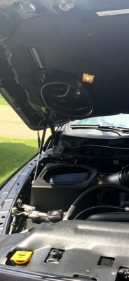

I’m running the intake your asking about the stock Mopar CAI and Ram Air Duct for a functional hood. Its an expensive choice, however I have no regrets. I have the Fastman 84mm Throttle Body on order should be receiving it soon. Felt that’s as big as I need to go with my list of bolt on mods.

I would highly suggest against against spending the $1000 it costs for the functional hood inserts and MOPAR CAI. The hood scoops are too far back and the small holes are in a negative pressure spot. You will get no additional cold air to the air box. Save the $1000 and get a vararam and other mods for the same price
