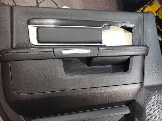

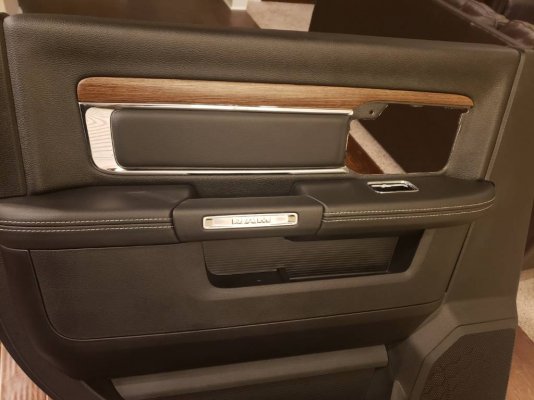

Here's some photos of the door trim. I also used 3M's brushed black metallic, so this is what it'll look like if you decide to go with it:

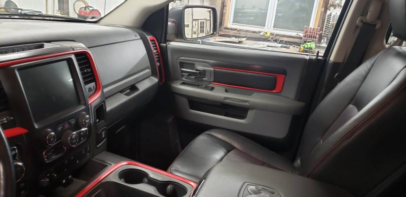

So it's been a while since I've had time to mess with my truck, but I've made some more changes! I wanted to match the door panels to the dash, but was a little intimidated by the plastic welds holding everything together. It wasn't as bad as I thought, a little time consuming though.
So here's the results:
Before:
After:
i know (now) that the center console is held together with welded spots, but the door panels that you wrapped, are those pieces also held in with plastic welded spots aswell?
Also see tools to plastic weld ram letters on an aftermarket eBay limited style grill... here.

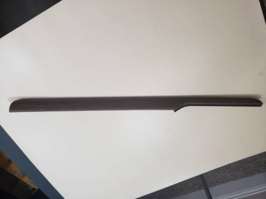

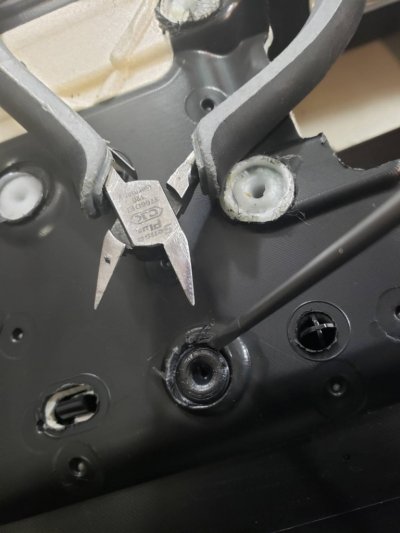

I can answer this. Just removed mine and wrapped the wood grain in 3m 1080 brushed black metallic... Had to cut off the plastic weld rivets, do the wrap and melt it back together once done with a plastic welding iron (or solder iron) ...33643b043b55978428aca0cf26d65825.jpg

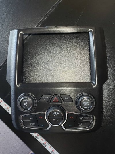

Also did this radio bezel that had a scratch on it a week later
... I was able to snip off the little weld tabs on the chrome trim, remove it and the translucent knob inserts and get a decent wrap. Still a huge PiTa. Online videos make it look super easy. Re-melted the chrome trim pins back once done with a soldering iron. 3m 1080 Brushed Black Metallic vinyl ...

Agreed. I really liked all the Laramie features but never liked the wood grain look/interior. Swapped out the steering wheel, dash and console cup holder assy with ones from a limited and very happy with it now. Took me about 3-4 hrs per door to do it this way so I could wrap it all the way behind the trim piece.
If you have any questions about getting the plastic rivets off (flush diag. cutters work great) or plastic welding it back just let new know. I forgot to take pictures of the re-melted mounts (harbor freight $17 iron/kit will get it done). There are also some useful YouTube videos that helped me out.

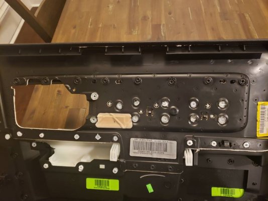

I can answer this. Just removed mine and wrapped the wood grain in 3m 1080 brushed black metallic... Had to cut off the plastic weld rivets, do the wrap and melt it back together once done with a plastic welding iron (or solder iron) ...33643b043b55978428aca0cf26d65825.jpge5a0ba16622dffca5647af6165b96788.jpgfdbd74a4af52e5d3f19c651f69967015.jpg9bc9d878092b5477936a73f3bfd8c786.jpg753add520b78f72e71f19b3074be83ea.jpgb57f750bc86574c9d3459c5a06942c01.jpg011a6b2d9501d06fb9b6980ab5ca5533.jpged859d5627c3efd90f8485f58b74819f.jpg
M² Mods.

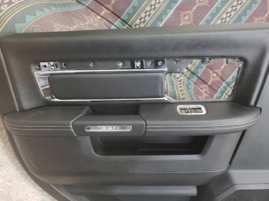

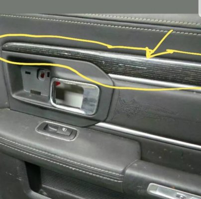

So did you only have to melt/break the red circles or did you also have to melt/break the blue ones as well? Just want to gain as much info as I can before I take my door panels off. I’m also going to take ChrisBH17’s idea and wrap the doors arm rest in leather. I’m going to order some from leather seats.com as it’s easy to order compared to Katzkin which you have to go through a reseller to purchase.
The red ones for the trim piece I wrapped and Chris would need the blue ones for the 'leather' wrapped armrest pad.

For extra clarification, you also need to cut the blue ones to get the silver/ chrome trim ring off as it's layered behind the armrest pad.

Yea I’ve never seen that before, pretty cool. Anyways, I tried to wrap my radio bezel and it was a NIGHTMARE because I didn’t know you could melt the tabs and separate the sides from the center, I was trying to vinyl wrap each side as once piece and could NOT get the vinyl to lineup properly with the indented line separating the sides from the center.

Did this one at the beginning of the week with a spare scratched bezel .
