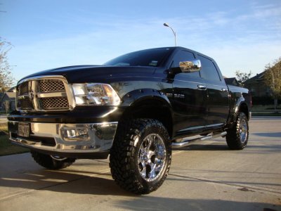

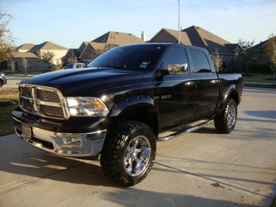

Here are some pics of the lift installed. This is the 7" CST 2wd kit. Just a heads up to anyone interested in buying this kit, the website and dealers tell you that new front shocks are not needed for this kit just use the stock ones. On top of that CST doesn't even offer front shocks for 2wd 09 rams. Well CST should supply a helmet with this kit because the ride was terrible!!! With the 3" coil spacers it makes the shocks top out and have no additional travel.
I took the truck back a few days later and had them pull out the stock shocks and throw on some 15.5" Procomps. This was about 2" longer than stock. Talk about night and day difference!!! With the longer front shocks it rides like a dream.
