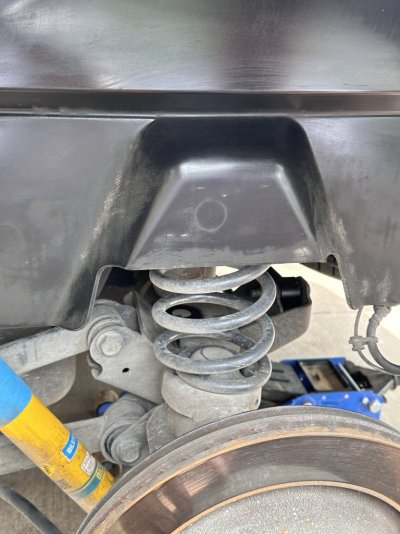

so i have a 2017 Ram Rt and decided to just level the truck with the front so i got some maxtrac rear drop springs that are 3inches and it lowered it only 2 inches and i refreshened all my shocks with billsteins 4100, and the truck rides really rough any little grove on the street or bug pothole the steering automatically follows it, then going 60-80mph on the freeway it has intense body roll, it never did this in stock height, anyone got any solutions?
I just installed a hellwig rear sway bar it helped a little but still feels bad and i ordered some rear belltech nitro shocks for the lowering
(Just saw how my spring was installed, i believe the installer didnt do a correct job…)

Three things
Look at picture 32, see if the springs you installed are clocked correctly, I know you didn't do an ihc kit but you still need to clock the springs. Yes it makes a difference. Also if you look at the belltech springs, they co.e with a trac bar relocation bracket to keep your track bar aligned and level
2, stock 4600s are ok, if you installed stock extenders but if you didn't, they could allow the springs to fall out due to extended travel. Change to a different shock, qa1s, vikings or even the bell techs you mentioned, however bell tech not my first choice.
3. I know you didn't mess with the front but did you get the truck re aligned. Your description of chasing road grooves usually occurs when alignment has been altered.

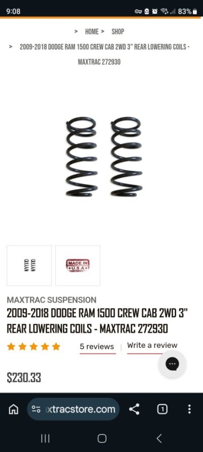

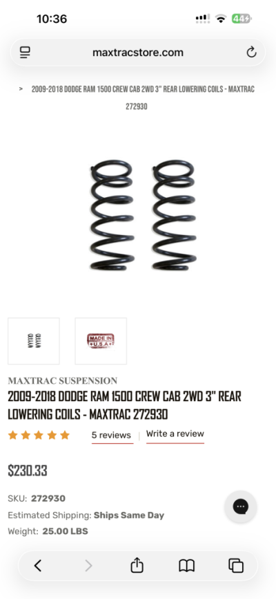

Last, are the max Trax springs progressive springs or standard springs. If they are standard then it will ride more firm, ie rough. If they are progressive then see item 1.
I looked online at the photos on the 3in lowering spring, they appear to be standard springs, ie no progressive, they will ride more firm. A progressive spring has tighter coil winding at the top than the bottom. See photo 3 & 4
I hope this helps.
PS, truck still looks too high in the front IMHO.

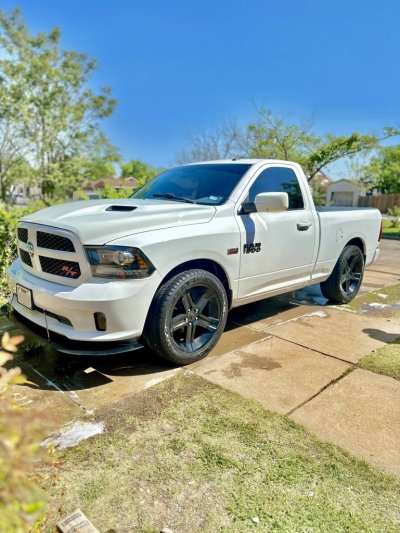

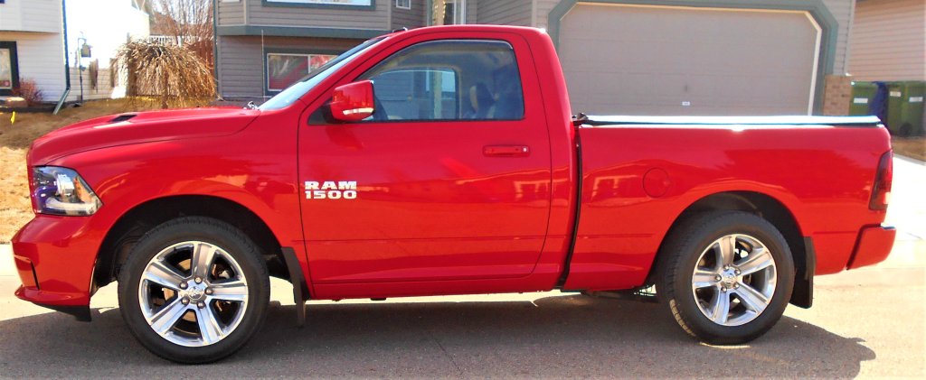

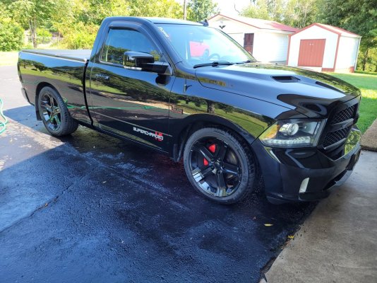

1st photo ground force 2/3. 285/45/22
Second photo ihc 6/4. 285/45/22 back 285/40/22 front.
Same truck

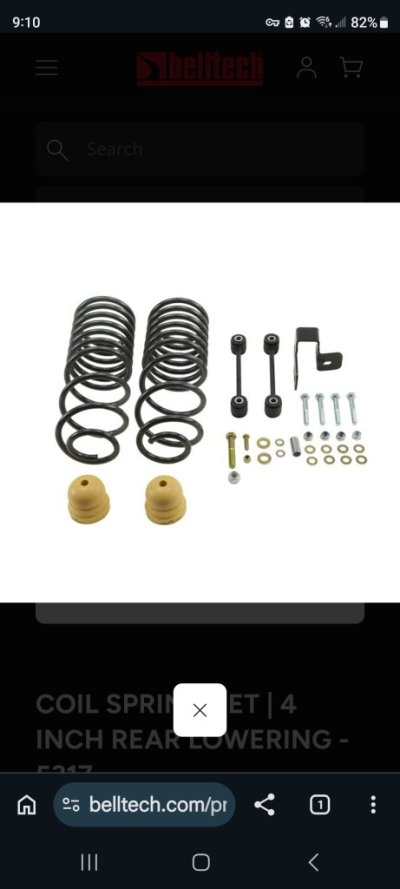

what shocks you recommend? i was just going to slap on the belltech ones because its the only brand i know
yes i got it aligned right after the installation but that was 7months ago. and the steering feels loose at times as well, i did recently replaced sway bar bushings and end links and my track bar so i need a new alignment.
i believe they are standard i have the sku of it on the picture below, but if thats the case then its better if i invest on quality springs and shocks if im already going all out.
I also forgot to mention im running 305/45/22 on all 4 so maybe thats something that causes the problem as well

I'd look into qa1s or viking double adjustable
Qa1s is probably my choice
Tire size should not matter as long as they do not rub.
The maxtrac springs should work but if you are unhappy with the ride, the belltech springs are widely available and a direct drop in, but they are a 4 inch drop. Belltech springs are progressive so they ride soft.
If your trav bar is not level, I'd start there, the relocation bracket is inexpensive or you can just re drill the hole to level it.
I've had 3 different sets of shocks on mine. The qa1s ride the best

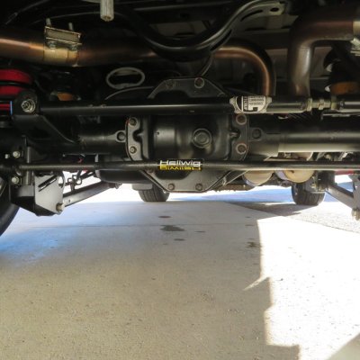

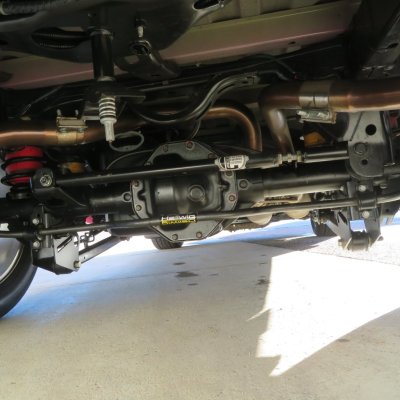

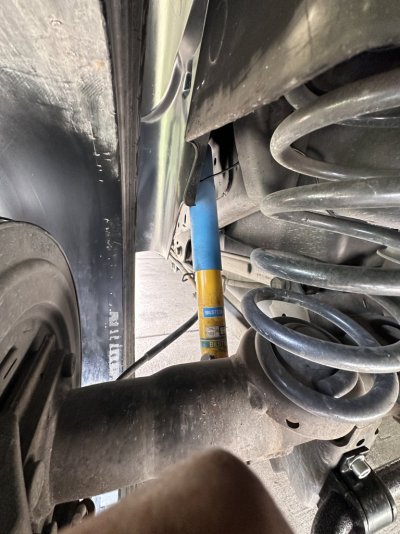

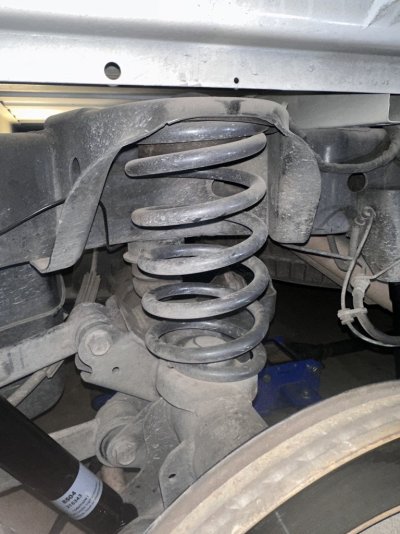

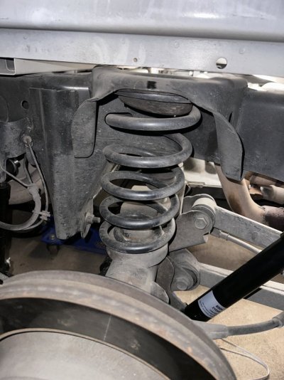

so i checked my springs while i was installing the shocks and i noticed the driver is a little off centered, i test drover it with the new shocks and springs like that still (no alignment) snd it absorbs bumps better but it cant go pass 70mph without the insane body roll i get still, so im going to get the springs checked today and will inform how it drives @Bigskyroadglide

If they are tilted and not straight up and down your will get some body roll.
You may need to look into the relocation bracket or re drilling your trac bar hole to get it straight.

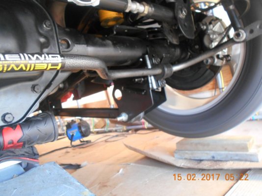

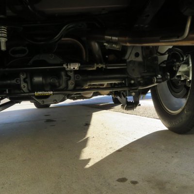

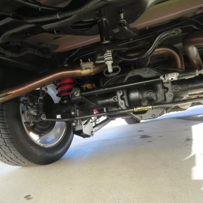

You need the relocation brackets for the locating arms,as that'll bring the rear suspension geometery back closer to factory.The arms will try to steer the rearend as they face uphill when you lower the trucks,and you need them closer to parrellel to counter that effect.
Look at my rear end,you can see the Illicit brackets move the arms down,and if you look close you can see how i moved the trackbar up to where it runs parrellel with the diff,by moving the locating holes up on the pass side frame bracket.

If your truck is feeling weird in the rear end you need the relocation brackets. Some trucks can get away without the brackets and some trucks need them,seems to be no ryhm or reason to why though.
My truck was dead stable to 155mph with the relocation brackets and redrilled track bar mounting hole,and it was about 3.5" lower in the rear,with cut down R/T springs

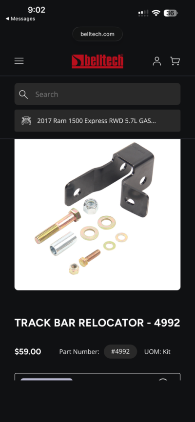

would it be this one on the picture below?
and if you dont mind explaining to me how would this help or fix the rear geometry?

That's the bracket, It allows the track bar to be level since you dropped the rear by putting in shorter springs.
A track bar relocation bracket is an aftermarket suspension component that lifts or lowers the mounting point of the track bar on a vehicle. Its primary purpose is to correct the steering and suspension geometry, reducing axle shift, eliminating bump steer, and improving handling by returning the track bar to a parallel position with the axle.
Does that help.

That's just the trackbar bracket,it doesn't do much to counter the rear end issues that come up by lowering a 4 link rear suspension,you need the relocation brackets for the locating arms that are on the front of the diff.The trackbar you can get away with redrilling the mounting hole on the frame side,look at my pics close and you can see how i moved the bar up by redrilling the hole.
This pic shows the relocation brackets for the locating arms,those are the ones you want,they correct the rear suspension geometery and will make your truck drive better,everything else is just a band-aid fix.

what relocation bracket for the arms did you use?
so if i just do the arms and the bar relocation brackets would the body roll be eliminated? it drives normal other then going 70mph + and then it starts having insane body roll, fells as if the truck is going to flip
Mine are the early Illicit relocation brackets,they aren't available anymore,but IHC's brackets are very similiar. If you do the relocation brackets for the diffs locating arms,and relocate your trackbar so it's level with the diff,your truck will drive just like stock.Plus the locating arm brackets will move the diff back to where it's centered in the wheel well. If you look at Bigs pictures in post #2 you can see his diff is pulled closer to the front of the wheelwell,which is a by product of lowering a 4th gen. Look at how my rear tires sit in the wheel well,they're virtually dead center in the wheel well.Go look close at your rear tires as odds are they'll be pulled towards the front of the wheel well
