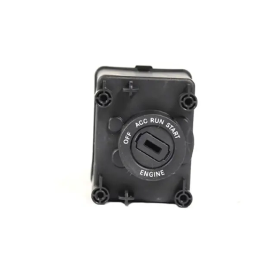

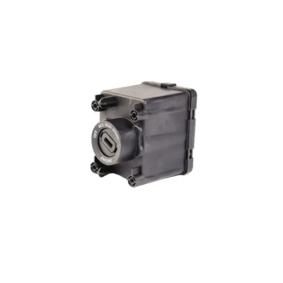

what is a WIN, Wireless Ignition Node, Node could also be a Module?
I believe with the system where you fit the FOB into the Ignition Switch, that Switch is the WIN
That might mean where the FOB remains in your pocket, would mean that the FOB is actually called an RKE, Remote Keyless Entry
With the RKE, the WIN is mounted on the rear cab wall, right next to the drivers side cab vent
This is only a educated guess on my part !!
With the WIN that is the Ignition Switch mounted on the Dashboard
In your mind, picture a Copper Coil inside the WIN
When you insert the FOB into the Ignition, part of the FOB is inside of the Copper Coil & a Security signal is triggered, that signal allows power to ECU & then the Starter.
Sometimes, i think something happens & the ECU just gets confused ??
Dirt inside of the FOB or the little round contacts inside the FOB can become detached.
