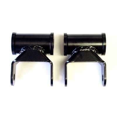

HemiBabe
Dec 6, 2010
7,214
922
DFW
When the leaf spring is in the stock position, the shorter the shackle, the more you drop.
When it is flipped, the longer the shackle, the lower you go.
This is what the correct 2" shackles look like for our trucks: [The OEM shackles are 2" longer]
