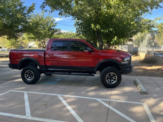

I initially had it leveled
Than lifted, what needs to be done to make the front match the back height?
Also anyone have ABS light issues after lifting?
New tires on the way! so I want the front as high as the back

Great looking truck! I have the front of mine a little lower, the hood/front of our trucks are higher than the back, a true level will look “nose high” IMO.
Thanks for the feed back, Thats what I thought as well, I've just seen some RAMs on the road that seem to look perfectly leveled, but usually on the freeway and had never been able to ask.

What has been done to this point ?
I just asked the shop for the exact specifications and model of the lift that was used. I asked for a 6-inch rough country - My truck is only a RWD so it's just for cosmetic purposes.
I looked online and there are only 2 lifts that fit my truck by Rough Country a 4 and a 6 with the 6inch coming with new springs.
Im now thinking he sold me a 4-inch lift as the 6-inch lift and its higher in the back because the warlock is already 1inch higher.

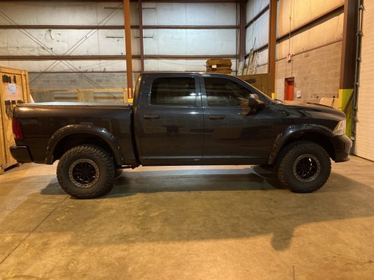

I have the RC 6 inch lift on mine when you buy it specify how big of coils you want in the back of your truck otherwise it will give it a 2 inch lift higher then front for the purpose of towing Mine sits dead level when i attach my RV or sxs n trailer
