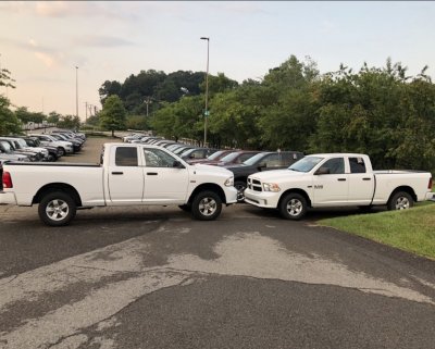

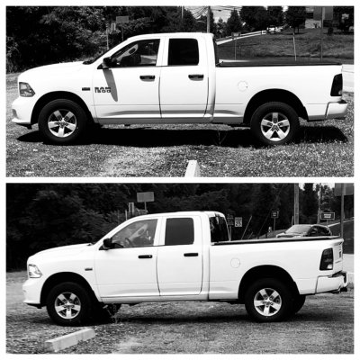

79A0787A-B93C-487C-AE1D-1D86CFF242DD.jpeg I have read every page concerning level kits/lifts and I went with Bilstein 6112 (preassembled), Zone UCA’s, bilstein 5100’s rear and Icon 1.5” coil springs. Had the dealer install everything and do alignment. They have a guy who does lifts and he is very knowledgeable. Truck looks good rides nice at all speeds but now in 4x4 I get he shudder. Measurements originally Front fender 36” rear fender 39”, now font 39” rear 40”. Stock wheels and tires ( 17”). My cv angles don’t look too steep but I want to get a diff drop kit. I read where a guy on here used one from zone any idea of other manufacturers make them and will it help?. Before and after pic

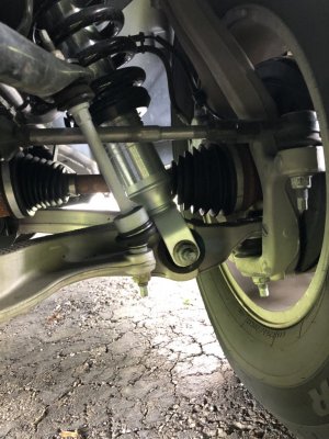

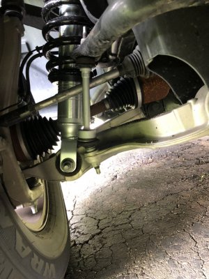

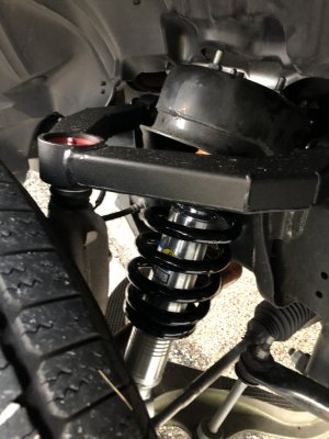

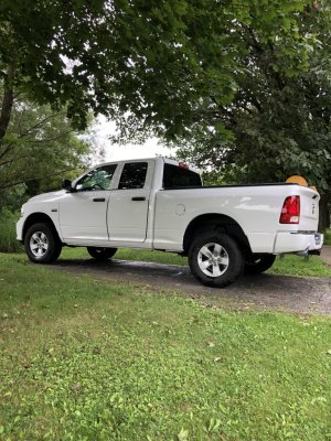

I found the 6112 preassembled on EBay, but DO NOT buy them from 1 source off-road, they sold them to me but were not in stock as listed then took 3 weeks to get them and it was sent in two packages, horrible communication and they had my $ from day one. They are set to #7 @ 2.6” Anyway here are some pictures.

Looking at your pictures and obviously the before and after measurement numbers you definitely ended up with more than the advertised lift. I'd wait and see if they settled a bit before changing the height and just be mindful while in 4wd. Maybe go take em and run em offroad a bit and give those new springs a chance to break in and settle a tad. Sucks that you have the shudder though.
