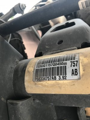

Look under your driver side rear differential, there’s a sticker that states exactly what gear ratio you have.
here’s mine
