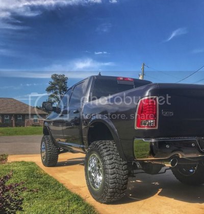

This is a 20x10 wheel with -12mm offset and a 295 wide Toyo m/t mud tire and oem 2500 flares

That'd be about the perfect width quietpeen.

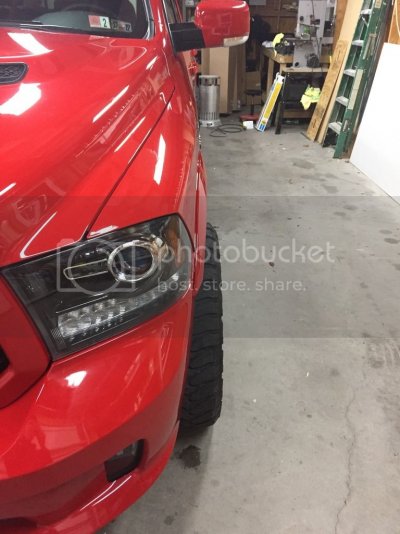

Not the best photo. I have 20x12 fuel maverick on 35 Toyo Mt. The wheels stick out just a bit past the flare not too bad though.

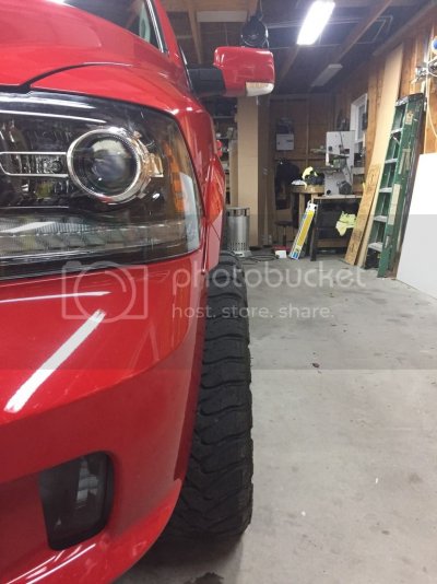

Here's mine with 20 x 9, 0 offset wheels and 295/65/20 toyo's. The edge of the tire is flush with the edge of the factory flares.

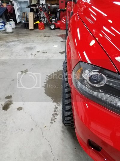

Think your flares will do much for protection on my setup?

this is the coverage they gave on my old wheels 20x10 -24mm offset with 33x12.5 tires

Okay awesome thanks, I'll probably end up going with those if any so the truck still has that nice and clean look

929rob the 295/65r20 is about 11.6" wide. Could you take a pic from straight ahead so i could see how the tires line up with the flares? If yours sit flush with the outer edge of the flares then a 35x12.5 on a 20x9 with 0 offset should be what i'm looking for. I'd like to sit flush with outside of flares or maybe up to an inch beyond them. Nothing more aggressive than that. Your truck is clean looking. Looks good.
