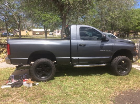

I just finally lifted the rear of my ram to match the front and now I'm noticing a lot of vibration while driving. I have two inch shackles and 3 inch blocks. Any ideas out there. Am I gonna have to get a longer drive shaft or any other ideas are greatly appreciated.vibration didn't come until after lift was installed.9e8588c3e239f8cbff972e64e30396bd.jpg

That's why I went with a longer shaft
Oh ok I think I remember you telling me that longer shaft to stop the vibration

I was gonna say prob has something to do with pinion angle on driveshaft with lift putting it at a ****** angle

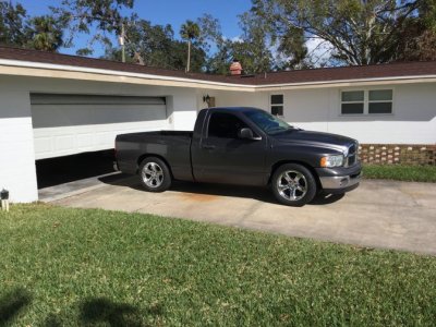

Edit I like to see your truck as mine on a lift lol
An hello from 3.5 hrs north

Haha looks like twins except one is up and one is down haha
I found the company where you got yours I found it on one of your old post they seem to be really really good. Do you happen to remember how long of a driveshaft you ordered or any information from it.

54" I think I added 1.5". I measured u joint to u joint

Pinion angle. The kit sellers never tell you about it.
