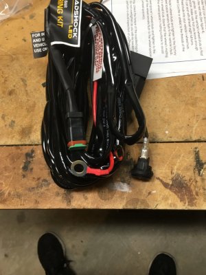

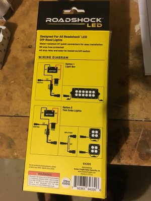

I may have found a solution for running the spot LED pods and found it, of all places, at Harbor Freight. I was headed there anyway to spend some Christmas money and needed some wire shrink wrap and a wire stripper/crimper for this project and wandered all over the store till I happened upon a solution.
We all know they sell those mediocre Badlands winches, but they’re also selling LED cubes and light bars. They’re similarly priced to most lower end pods and bars but the wiring harness was what caught my eye.

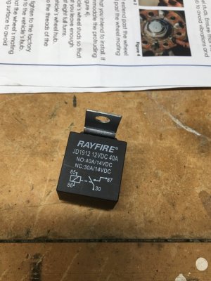

As you can see in the pics it’s got your simple switch, but it has an (30 amp) inline fuse and “waterproof” (40 amp) relay and Deutche connectors. It also includes a splitter to run dual LED pods. For $25 (I used a 20% coupon so it was $20 and taxes) and you can get it locally, so it seems like a pretty good deal. I haven’t yet pulled it all outta the box and laid it all out, but while in-store I inspected what I could on the shelf and it looks like most (made in China) kits that you could get on Amazon or EBay from a myriad of manufacturers.

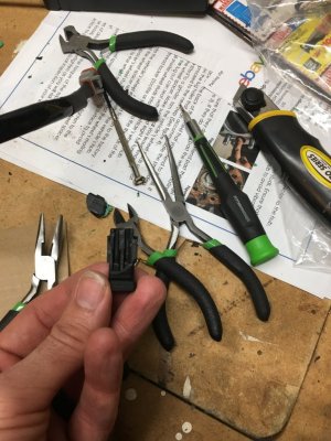

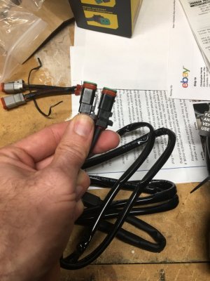

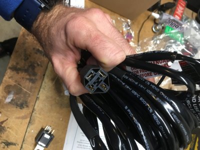

I dug into the box and pulled everything out. The instructions are very self explanatory, they give you 3/5/7.5/10 amp fuses, the relay wiring (from light) is already setup with a direct plug to the relay itself, the wiring looks good except they used black Deutche connectors. I tried to connect them to the grey Deutche connectors on my LED pods and the would not click in, I even tried to pull up on the tab to see if I could give it some motivation but ended up busting the retaining tab. They are also wired backwards so I’ll have to take them apart and repin them anyways, I have spare Deutche connectors so I’m covered there. All in all, looks like a good product for $25.

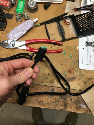

This is the splitter, I busted one tab (right)

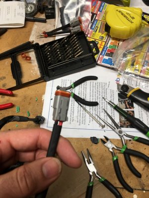

A PSA on the Harbor Freight wiring kit, the Deutche connectors are sub par.
A little disappointment, yet not really surprised. In my efforts of swapping out the Deutche connectors ON THE SPLITTER, I found that the (green) retaining caps (they’re usually orange, shoulda been a dead giveaway) were actually glued to the Deutche housing. Luckily, I just used some pliers, and carefully cracked the housing to extricate the wire ends and swapped them into proper (gray) Deutche connectors. The wiring was not damaged in the process.
Additionally, the HF Deutche connectors (black) work perfectly fine and latch positively to themselves. The issues I had was attaching the HF Deutche connectors on the splitter to my LED pod Deutche connectors as they are the “correct” type, grey bodies with orange retaining caps.
You get what you pay for, but it still worked out for me anyways.
The aftermath
Fixed
Crunchy Deutche housing
Retaining tab glued to Deutche housing
