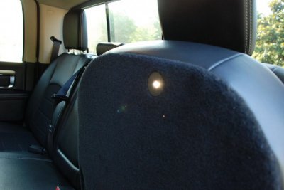

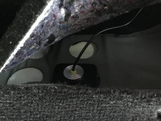

You have to buy the harness that goes between the 2 bulbs to the harness connector on the floor & seat frame
try these numbers in your search
I think this was in a long, (post on another forum), conversation between Benny & a customer in 2018

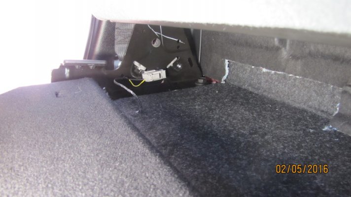

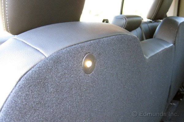

5507286AC (for the light itself) and 5KX15DX9AB (for the bezel). I also noticed when I was at the dealer yesterday that those lights do not plug directly into the connector attached to the seats, they use a small pigtail between the two. That pigtail had the following markings on the tag: EDS Mfg Mexico 20151201 Rev 5 2401387. The last number, 2401387, when searched led to this: 68217325AA ; 68157125AA.
Not true about the pigtail. That is only if you have heated rear seats and seat lighting. According to the wiring diagram, there is only one connection, and that is at the supplied connector on the side of the seat.
