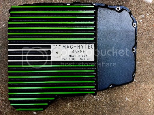

I'm rather new to painting (first attempt, yup, that new) and quite happy with the color/outcome, but I noticed the edges have slight "burring." I first assumed I waited a tad long to remove the tape, but the paint isn't actually coming off. Once it completely dries is there a polishing/sanding that will clean up the edges? FYI, the top of the fins, now painted, were like a metal strip so nothing plastic (not sure if that determines what's best to use polishing/sanding wise).

Well done! When I saw the title of this thread I was expecting to see something that looked like ass. You did a great job, it looks great. I'm not sure you need to do anything else to it.

That came out good! I see what you're saying about the rough edges. I wouldnt worry to much about it seeing how when its mounted you wont notice it.

I don't see it. All I see is the texture of the black powder coating.

Appreciate the positive responses. Basically this was my test because I knew if I messed up it wouldn't be seen anyways (the differential pan will be next and is visible...I'm nit picky lol ). I just need to know what kind of sanding (grit) can be used to smooth/polish without actually stripping away the paint, which should also clean up the edges?

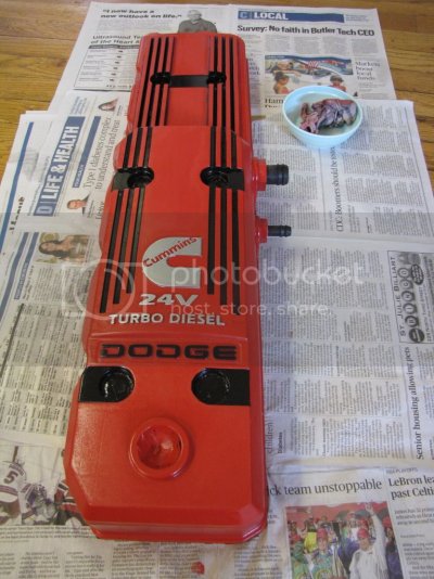

Here is a before and after of my valve cover with wetsanding and clearing:
Before:
You can see the tape lines/imperfections clearly:

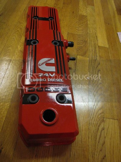

After:
You don't see any of the imperfections anymore!
