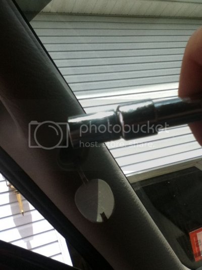

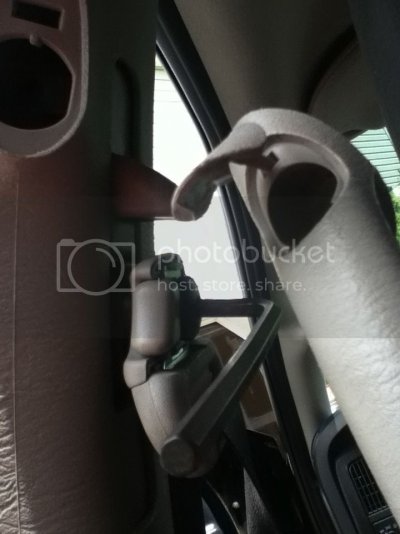

Just pry the holed open with a screw driver and use a 10mm socket to get the 2 screws out. Also do this for the back 2 handles. These two pillars were a little tricky to get off. In the front by the windshield and on the dash there are 3 inserts where it is still connected and takes a little playing around to worth them free.

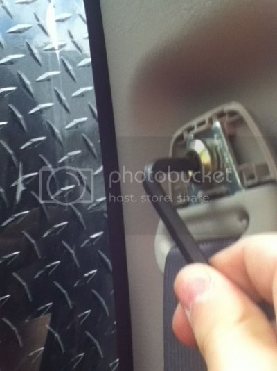

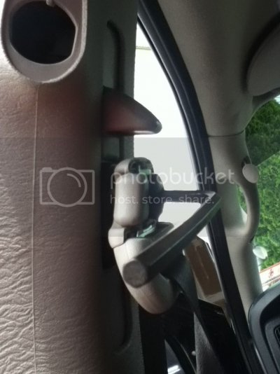

Next go to the back and take off thoes 2 handles just like the first but the handles come off seperatley. Then take off the cap that is on the seatbelt and take an allen wrench and screw that seatbelt off. From there it is eay to pop off that molding.

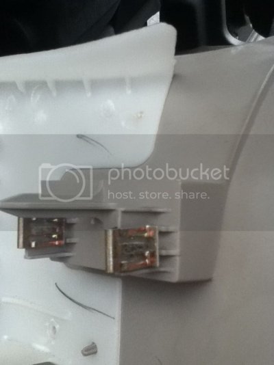

These little clipes are on all of the moldings but on the back one there are three of them which makes getting them out a little difficult at first but once you know where all of them are you can just pop them right out.

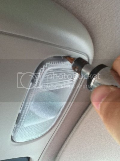

next pop the covers off the map lights and there will be 2 screws in there that you unscrew and this will allow the unit to hang down. there are 2 clips on the back of it, they are easy to find and that will help you get it down.
from there there are 2 wires that are clipped into the units, just unclip the white one first bc it is easier. the black one I had troubl with so I unscrewed the screen from the unit and this actually made it easier to spray the unit later on.

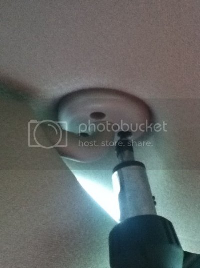

Take out the screen for the dome light and then wiggle that down. There is also a wire that clips onto that unit as well and just unplug that and take it off

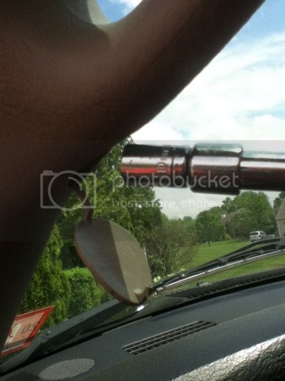

Next unscrew the 3 screws on you visors and pull them out. Mine dont have anylights on the mirrors so I didnt have to worry about any wires in there. For the other hooks that are there, grip the botton of it and pull down. This will seperate and make a big space in the hook. From there you can just pull them out. You can do the same for the clips in the back.

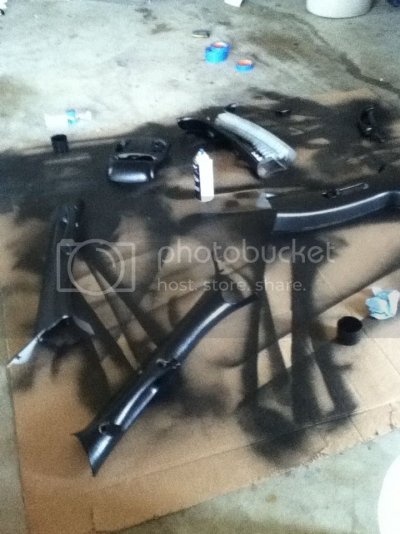

When painting your plastic go in long passes across the plasitc longways. Do very very light coats so the paint gets a chance to stick to the plastics. I did like 6 to 8 very light coats. You will see if you go on to thick that it will look like it dosent want to stick to the plastic at all. Trust me spray it so it looks like you are hardly putting anything on and keep going from there. it dries quick so just keep going around in a circle spraying every part so it goes quicker.

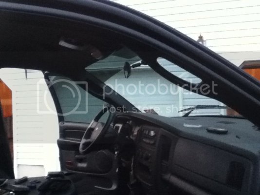

After you get all of the parts painted you can do the headliner. Once all the the clips and molding is removed the liner will come down.

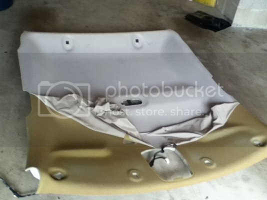

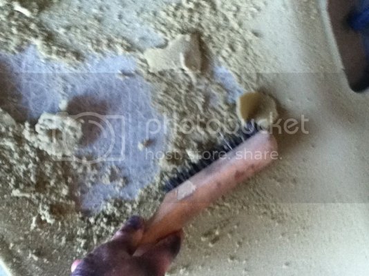

Start peeling off the headliner. You will not be able to get the foam off with the cloth and thats where the wire bruch comes in. You have to take that and scrape off as much foam as you can. The more you take off the better it will look because it will let the new liner stick better.
It takes a long time and this is when its good to have patience and beer. Also a little help switching on and off if you have it which I did not.

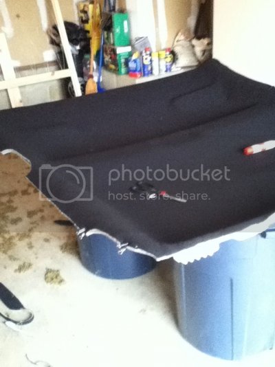

When you finish that, lay you liner on top of the board and then fold it half way over.

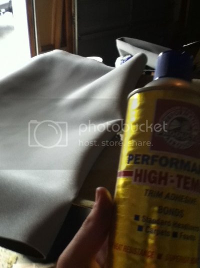

Take your glue and give it a good shake and spray it evenly on both the board and the new liner. Make sure you get the edges coated well.

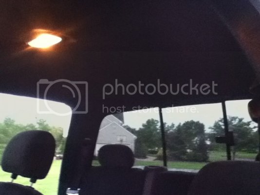

When you glue it, lay the liner on evenly starting from the middle with you hand and rubbing to the edge. Be aware of the indents in the liner to make sure to allow slack to get into there. Let it sit and trim off the edges. I did not have anough glue in some parts on the edge because I ran out. A hot glue gun works great to fix this problem.
