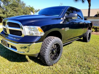

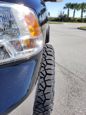

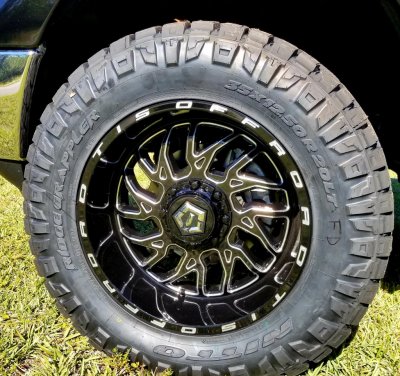

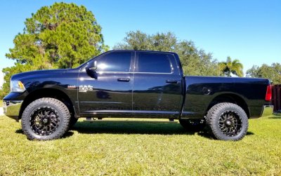

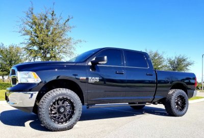

Just had the Maxtrac 4.5" lift with 3" coils for rear installed professionally with
TIS -26 offset rims with Nitto Graplers 35"x12.5"/R20
Also installed myself AMP Research power running boards, and had to modify the 2" extensions to work with the boards
Pics don't show the black RAM emblems I installed today, which took 3 hours to remove the old ones and install the new ones
I also have a Gator Hard Tonneau cover installed20210109_130102.jpg 20210109_130153.jpg 20210109_130219.jpg 20210109_130102.jpg 20210109_130153.jpg 20210109_130219.jpg 20210109_130131.jpg 20210109_130532.jpg
I'm really happy with everything, the thing I'm not sure of was maybe going with
22" rims vs 20"
Ride quality is like stock, only difference is I feel going from a P rated tire to load F
I'm running the tires at 45psi, even though their rated at max 80 psi
Stock fender heights with 31" OEM tires was 36" front, 38-1/2" rear
Top of OEM running boards 13"
Lifted it sits at 42-1/2" to bottom of fenders perfectly leveled
Top of running boards were at 15" , with 2" extensions now at 13" , same height as stock
Me and the wife can easily get in and out of the truck, the AMP power running boards allowed me to lift the truck and not have to worry about getting in and out

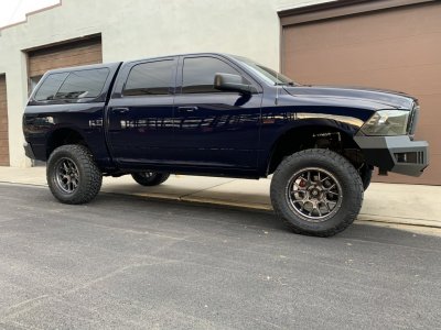

Truck is looking great. I did not do the extensions on my amp steps so they would tuck all the way. Small kids and wife still have no issues during entry/exit
Here is a picture of mine so you can see how flush they can go without the extensions. I’m also higher 6” lift with 36” tires
