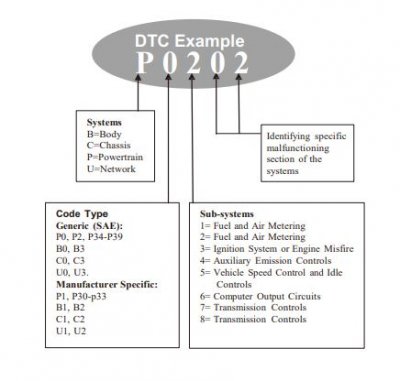

"Mode $07 – Request for DTCs (pending) from Continuously Monitored Systems after a single driving cycle has been performed to determine if repair has fixed a problem. This is used by service technicians to verify repair was performed properly and after clearing DTCs'
If it is ABS or SRS you will need a reader that will read them. There are generally 3 types of handheld readers OBD $, OBD+ABS $$ and OBD+ABS+SRS $$$. When I had speed sensors issues with my Jeep I had to get one that read ABS codes
I think you need to find a DTC code
